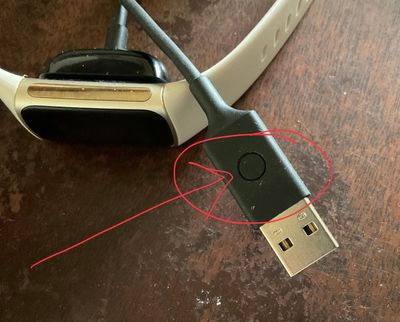

I have the same problem, however I cannot see a button on the charger - how can you reset it without a button?
Thanks,
Isabelle
Best Answer06-30-2023 02:30
06-30-2023 02:30
Hi, @Louhendrix , below a picture of where to find the button on the Charge 5 charger. If you are using the charging cord supplied with your Fitbit it will be there. However if you have bought a third party replacement charger it may not have the button.
