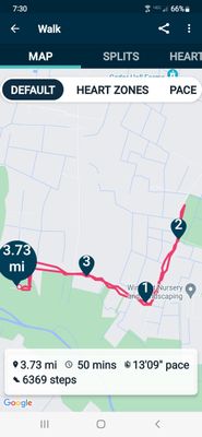

This is an example of how my GPS is mapping my walks. I walked straight out and back. Anyone else?

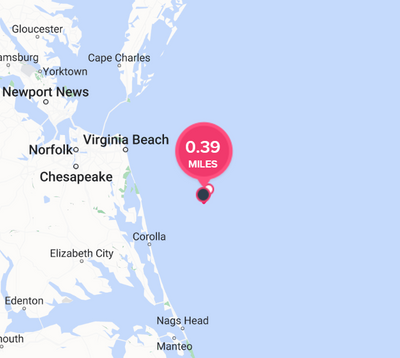

I have tried all the settings and still get Inaccurate mapping. It can be as much as half a mile off and spit time as much as 1.5 minutes off.

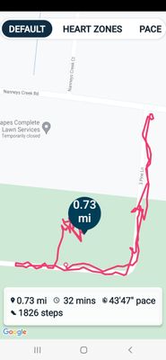

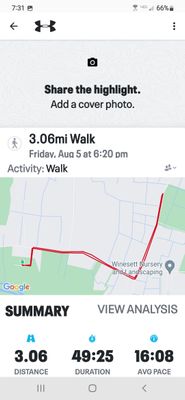

This Is the same walk. Fitbit was set on dynamic. I get the same results when gps is set on phone. 7tenths of a mile is just too far off. Has to be something with the fitbit. Ant other suggestions? I've tried all the ones you mentioned.
