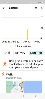

Not sure we're using same app or device. Screen shot of my app. Icon of watch doesn't change regardless of options I choose on watch

I am also getting the message to use the app tp map the route and pace. I have previously been able to use the watch for that - and I want to be able to see my pace when I am exercising without having to get out the phone and look at the app. why did this change?
