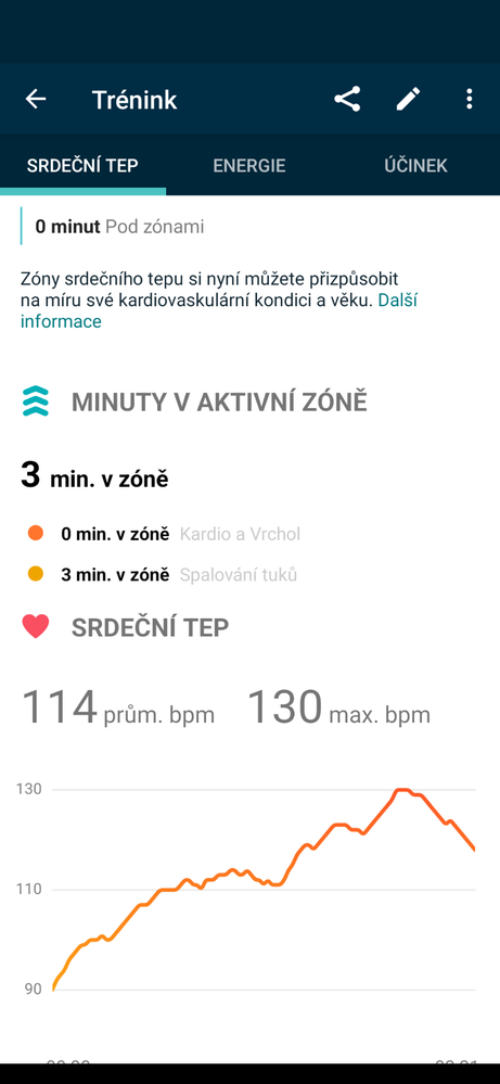

Exactly the same issue here. I can sit at a desk with my Fitbit showing a correct value of ca. 60BPM. Than I start the exercise and continue sitting at the desk. The Fitbit starts with correct HR reading and slowly increases until it reaches around 120BPM. It tracks the sitting as a calorie burn exercise (see attached picture). Interestingly I had this behavior with my Charge 2 and Charge 3 as well. So I am very surprised, that someone is able to track the exercise correctly here. I basically end up just wearing the fitbit on my hand becuase in this state the tracking is ok.

Hi, thank you for the screenshots, for confirming that you've been experiencing the same problem with your Charge 5 and that you already tried a few troubleshooting steps, @HeyPap @Jenda.
In this case, if you already tried all the general recommendations mentioned here earlier to improve the accuracy of heart rate and you continue to experience the same problem during your workouts, I do recommend that you get in touch with the Customer Support team for further assistance with this. The best way to get help for this problem is to chat with us online or give us a call. Click here to get connected.
