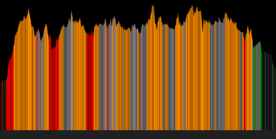

The following is a plot of my heart rate on my most recent workout, taken from the data recorded using the "Workout" exercise program on the Fitbit and extracted from the data export.
(this is a custom analysis that I've done by quickly hacking together some software to perform an analysis on the fitbit data export - you won't find this view on the app or website)
The colors show the Fitbit unit's confidence level reported for each reading in my exported data.
Red = "0" - this shows "--" on the Fitbit display while exercising.
Orange = "1"
Grey = "2"
Green = "3" - this seems to be the highest confidence value that I've seen it report, so I presume the max.
The "Workout" exercise program for me almost always starts of with "--" on the display and confidence of "0" even if the unit was showing a heart rate on the home screen immediately before hand.
For a fitness tracker that I bought thinking it would give me a reading of my heart rate to better estimate calorie burn, etc, I'm bitterly disappointed. It really seems to struggle - and when even readings with a confidence level of "2" can be quite some way out, seeing much of my exercise recorded as confidence 0 or 1 does not inspire confidence (excuse the pun)!
When the promo videos for the charge 5 show people kick boxing wearing the fitbit, I expected that it would be a lot more robust and accurate tracking heart rate during a workout.
It's also curious how most of the red / zero confidence, tends to occur at the beginning of my work out. The more sweaty I get, and the more I get into the workout, the more confident the fitbit seems to get at measuring my heart rate. Which is at odds with other reports that suggest sweat can cause problems with the readings.
I suspect it's a reflection of how much it's using an 'algorithm' to try to analyse the senor data to arrive at a heart rate reading. Contrary to the impression they give about the great specific wavelength of light sensor, etc i suspect the input signal is very noisy, and they're in essence having to 'guess' half the time, and I suspect this is why they appear to be taking into account the type of exercise you tell it you're doing, and I also suspect there's an awful lot of averaging / smoothing going on.. by that I mean when it's struggling, it is probably looking at what the previous heart rate was when it was more confidence and biasing the current reading towards that, and things like that. .
But if those previous readings weren't all that accurate, then all that does is persist the inaccuracy. And I get the feeling that is happening quite a bit.
All in all, I'm not impressed. I thought the special wavelength HR sensor would have 'seen through' all the motion in your arms, etc. The more I'm seeing, however, the more I get the feeling that the sensor isn't anywhere near as good as they'd like us to believe at seeing the changes in your physiology associate with your pulse, and they're trying to make up for the shortfall algorithmically.
