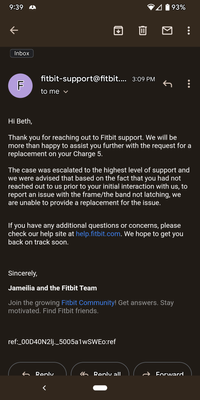

I did contact customer service about this issue and they told me that since they can’t see the defect in the photo they asked me to send that they can’t do anything about. I’m really disappointed. I’ve had various Fitbit products for years, but this is making me rethink my brand loyalty.
Absolutely agree. I am really disappointed in the Charge 5.
