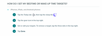

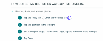

Hello @Rizla
Can I ask exactly what you're trying to set up please? Is it start and stop times that you are aiming to sleep between? Are you trying to get reminders to get some rest?
If you want to set up the times, you can do it straight from the app by following these instructions:
These shouldn't affect the ability to track your sleep. That should be automatic. You don't need to set anything or press any buttons for that. The Charge 5 automatically recognizes you're sleeping by the lack of movement and slowed heart rate.

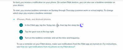

I'm wondering if you might be setting this instead by mistake:
If that's the case, you can just go back and switch that to off and the schedule to off too.
I hope that helps. If it doesn't please try to give more details about you problem and include screenshots as it makes it much easier and quicker to help you.

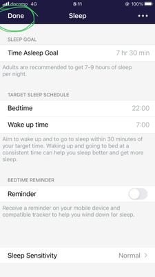

Actually, have you tried doing it from the Today screen?
That might work better as you can tap Done when you've finished.

I don’t think you need an OK button, just press Done when you’ve finished. Have you tried that yet?
I think that’s the way it’s saved. As you can see mine are switched to off because I don’t want that function. If you switch Reminders to On, you should get reminders sent to your phone too (if you want that).
