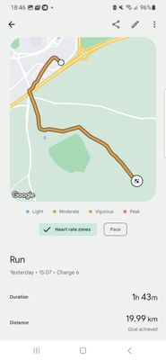

Using built-in and dynamic GPS is rather pointless. These two modes just don't work. I started using 'Phone' but this is also quite tricky and may fail. GPS connection is probably the worst feature of Charge 6. On my yesterday run, I gave a go to Dynamic mode again and failed as expected:
It failed 5km in and never recovered. It tracked whole distance (although wrong but this is another thing about Charge 6 that never works) because it used steps for it. Using 'Phone' GPS mode works best but that depends on phone and BT connection which often is unstable. I haven't found any solution to that. Charge 6 GPS implementation is just horribly bad 🤷
