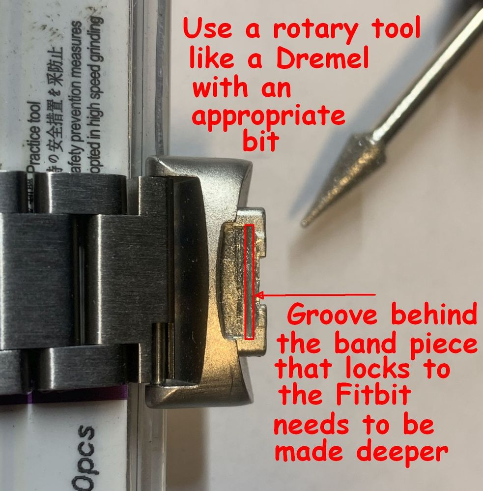

Same thing is happening to me... I have a couple ideas that I am going to try... I think the issue may be the replacement metal bracelet band that I put on soon after I got the Fitbit 6... I'm not a fan of the original supplied rubber bands, and have been using similar metal bracelet types on my previous Charge 5 and 4 that eventually stopped working properly... so I'm re-installing the original band to see what happens... if I don't end up losing it !
09-13-2025 08:30
09-13-2025 08:30
I am not having a problem with the original rubber Fitbit Charge 6 band that I reinstalled after wearing it for several days... so I decided to see what the problem might be with the replacement metal bracelet band might be... it seem to work find for several days when I first received it, but I had it fall off a few times recently.
From what I could tell, the issue is that the groove behind the locking piece on the metal bracelet is not quite deep enough, so I deepened the groove a bit by relieving some metal using my Dremel tool and a pointed bit.
The band now locks in place, and I cannot pull it out by tugging on it... I have worn it for several days, so I decided to report my finding... here is a photo to help show what I did... this may be an issue with other replacement bands.
