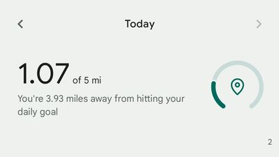

I completed the below walk, noting 3.32 miles. This is a specifically recorded exercise that I logged.
The issues is that thus then does not reflect in the daily totals, on top of all my normal daily steps.
It's clear this is wrong if you simply note the distance walked in this particular hour (3.32 miles) and then note that the daily total is only stating 1.07 miles!
Can anyone help? I've tried forcing a sync, turning Bluetooth on and off, restarting the device, double checking stride length, and nothing seems to work.

@ShaneLC In your specific case, the reply given by @Julia_G won't help you. You used the Outdoor Workout shortcut, a shortcut designed for non-step based activities like downhill skiing. It behaves like the Bike shortcut. Your daily distance total is for step based activities. Do not use this shortcut if you are walking, running, hiking or any other activity where you are putting one foot in front of the other on the ground.
