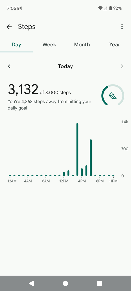

07-31-2025 16:09 - edited 07-31-2025 16:15
Just looked at mine and it looks correct. It's been raining off and on all day so I haven't been out much but just did a Target run which you can see. Did an earlier outing but got bored - lousy weather.
