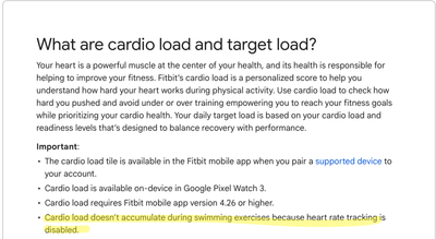

Can someone from google support please respond to this issue. You also need to update your help as it should state that cardio load does not work for spinning activity. A notice similar to the one you publish for swimming would be honest and upfront - especially for future customers to make an informed decision based on functionality that actually works. Thanks.
