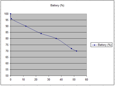

Update on my Ionic's battery usage
Charged to 100%
+30 mins 96%
+12 hours 90%
+24 hours 84%
+36 hours 80%
+48 hours 72%
+52 hours 70%
If I ignore the 100% and say that full battery was 96%, then battery has gone down at 0.5% per hour over the last 2 days. The value at 36 hours is just above the straight line, but as the battery doesn't display to any decimal points this might have been nearly 79% which puts in on straight the line.
My feeling in that once the battery goes below 50% the rate increases, it will be interesting to see if it does.

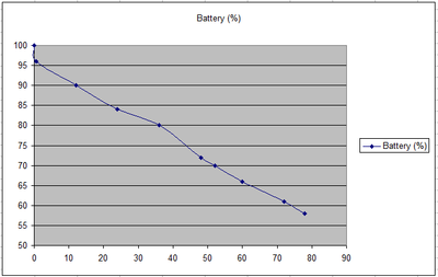

+60 hours 66%
+73 hours 61%
+78 hours 58%
Still on the 0.5% per hour line
Robin

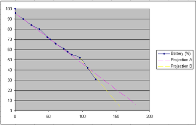

Time for another graph.....
Up to 100 hours my usage had been going down at about 0.5% per hour, but it took a sharp turn on Saturday and dropped at 0.8% per hour. On Sunday morning it was down to 31% and as I was going out all day and didn't want it to go flat I recharged it.
I have added a couple of projection lines, one at 0.5% per hour which matched the data to 100 hours (50% battery) and then a second at 0.8% per hour from 100 hours. If my Ionic had drained at 0.5% per hour, it would have made 190 hours (8 days) and it would have made 160 hours (6.6 days) on 0.8% per hour, still a lot better than I was getting after firmware update and before switching off the heart rate.
In 24 hours since the recharge, I have gone from 100% to 86%, still pretty much on my curve from last week.
