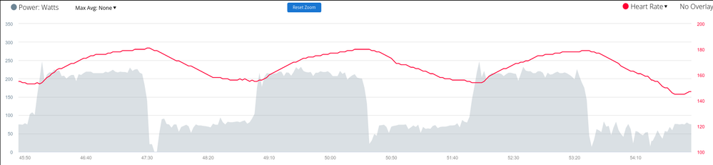

Edit: I think you may find this interesting. It was one of HIIT workouts of 15 intervals based on power output:
It shows quite well the relation between power and HR. Power is instant, HR very smooth. Although, in this example HR drops immediately when my power output also drops but the explanation of it could be that technically my HR couldn't increase any more.

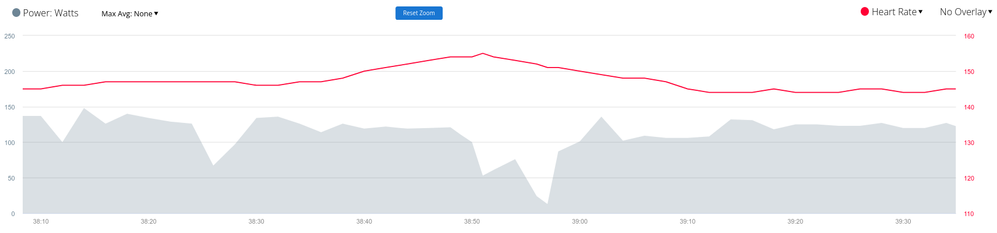

Edit(again): @Heybales I did more digging through my records and found better example on the bike:
It's pretty much what I mentioned in the beginning about staying in the zone. I think this smooth speed up/slow down is better visible for lower ranges of HR. When my HR started reaching 153, I dropped power, it still spiked a while but then dropped a bit so I added more power. Interesting thing is that for the same effort it still drops smoothly for quite a while. Humans are very interesting machines 😄
