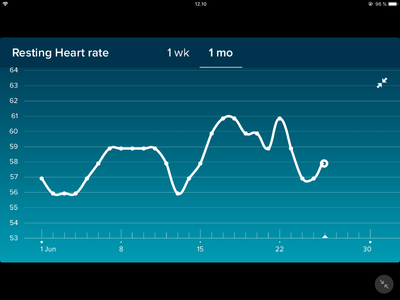

Fitbit reports resting HR as a single value for each day. Are you saying the graph that displays RHR for the past 30 days puts all values between 100 and 109? Can you post what a typical 24-hour HR graph looks like for you? This is mine for yesterday:
And this is the 30-day graph for RHR:
I’d be surprised if HR values during your sleep were in the 100-110 range.
