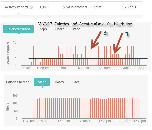

Probably the change could be for another reason.The incorrect calculation of VAM in the algorithms. If you look at this graph, all of the calories, if applied manually over the time would give me 100% VAM, that is from the Fitbit tracker, not my HRM.
Look at the consistency of the number of steps, the pace and the spikes of VAM calories should not be there. I received 26 minutes of VAM for this 53 minutes brisk walk. The low spike was waiting for the traffic at an interection on my walk.
Still awaiting answers from support to explain because in other areas and posts Support say the calculation is based on 60 second intervals so there is no explanation for the spikes..
