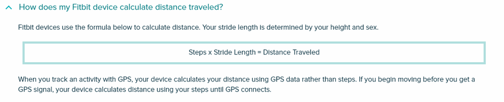

I walk the exact same path every morning at the same pace. But the tracking varies. For example: over the last three days the distance has been recorded as 1.8, 2.06, 2.23 miles; the speed has been 16.42, 14.43, and 13.56. How can the accuracy be improved?

@PresbyPastor Hello! Do you track this by using the Walk exercise on your Inspire 3? Or are you allowing it to automatically track it? Below is an explanation of how Fitbit calculates distance. You can also check out a few of these help articles:
How does my Fitbit device calculate my daily activity?
How do I track my workouts with my Fitbit device?
