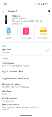

Hey everybody,
I got my new Fitbit Inspire 3 from the store. Running on firmware 188.58. According to the fitbit help site latest update must be Version 214.24.
But it does not show up in the app. Using my Inspire 3 for two weeks wearing it every single day.
I tried to do a soft reset, hard reset, delete all user data, disconnect form my phone, reconnect. Update just does not show up...
Any ideas how to get the update? In the older Fitbit app there was a help section where I could manually search for an update. But they removed it with all their fancy app updates 😄
