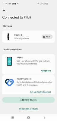

Many people on this forum have been reporting issues with the step count on the device being different than the step count on the app and a couple of Moderators have mentioned that this problem is caused by having an undocumented feature referred to as MobileTrack enabled on the app.
MobileTrack basically uses the accelerometer in your phone to measure steps when you are not wearing your fitbit device and the device step count is supposed to take priority over the phone step count when one is wearing their Fitbit device, but it apparently doesn't work very well.
Tap the Devices icon in the upper left-hand corner of the app screen and take a look at what shows up in the the 'Devices' list. If the Inspire 3 and the phone are both in the Devices list, then MobileTrack is enabled.
To disable MobileTrack, simply remove your phone from the Devices list, which should resolve the step count issue.
