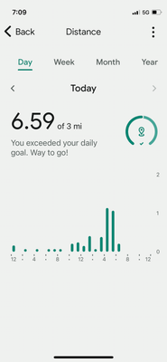

My total miles shows 6.59 miles but when I add up the miles in each bar of the chart it only totals 4.04 miles.
Why is this?
Where is FitBit pulling the 6.59 number from?
The 4.04 is pretty accurate to what I walked today.

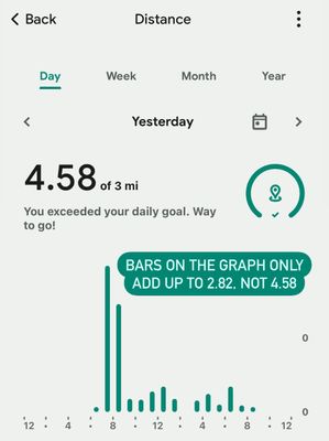

Hi @CKorrow I am having this same issue with the daily distance graph. I am asking some of my Product Expert friends if they are also having this issue. It’s likely a bug.
Best Answer@CKorrow @Heather-S I looked at my graphs and am seeing the same thing. This is certainly a bug and it looks like a really weird mile to kilometer mismatch. When I do the math on your screenshots, your miles are being converted to km in the bar graph. 6.59 km is about 4.04 mi. 4.58 km is about 2.82 mi. The same thing happens on my graphs.
@CKorrow You wrote that you thought 4.04 seems right. What is your step count for that distance? 2000 steps per mile is a rough starting place. Is your step count closer to 8000 or 13000?

Thank you! The step count was over 16,000! Which I know couldn’t be correct. I haven’t gone back to check all of my previous entries to see how long the readings have been so wrong. 😞 Any tips on fixing the bug?
Best AnswerAnd it does look like it’s been giving the false readings since I started wearing it, a month ago. And based on your estimate @LZeeW it is way overestimating my number of steps. I did just update the app and restart the device.
