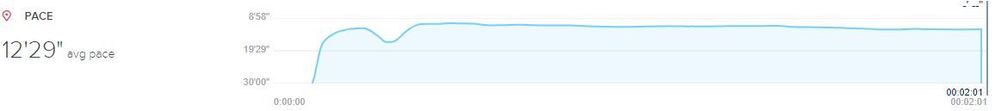

2 minute run.JPGThe crashing problem is not fixed with OS 2.1 firmware.   Here's how I tested it:
1. Uploaded new firmware last evening, took about 30 minutes.
2. Reset Ionic after update.
3. Using Android app, turned on Auto-pause and Run Cue (set for 2 minute intervals).
4. This morning, started the Run exercise app on the Ionic.
5. At the 2 minute mark, Run Cue went off properly.
6. Run app shut off, ending the run (photo attached).
7. Using Android app, shut off Auto-pause and Run Cue.  Synced with Ionic.
8. Restarted run, Ionic tracked everything OK.
I use Run Cue for a Galloway run/walk interval timer.  Please fix this.
Update: I just finished a chat session with support.  Apparently the crashing problem was not fixed in OS 2.1.  Engineers are aware of the problem and are working on a fix.  No timeframe for the fix, however.  Hope it's near the top of the list, since this used to work before the OS 2.0 update.
