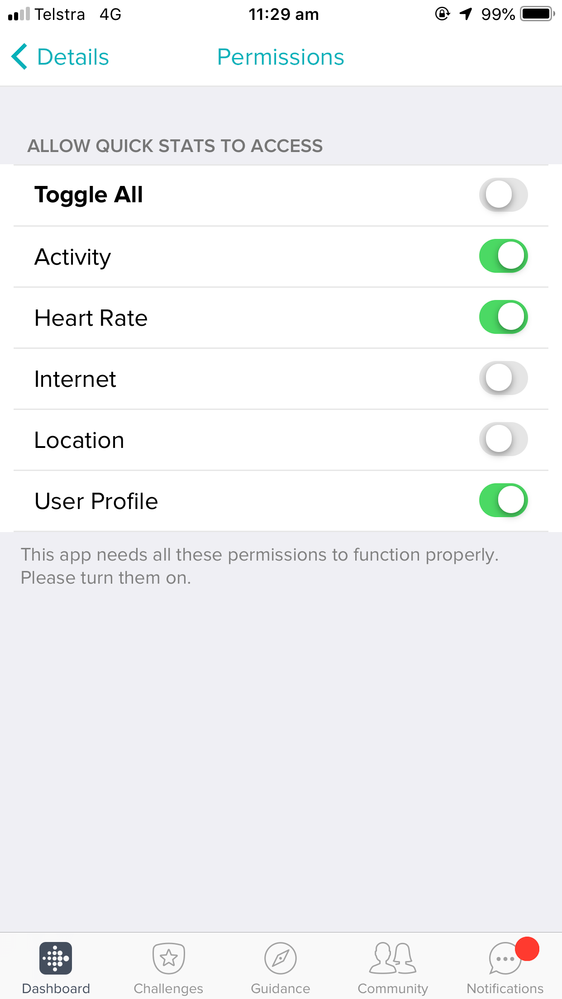

I’ve been able to get mine to work with custom watch faces only if I go into the settings of the watch face via the Fitbit app on my phone and turning off internet and location in the watch faces settings. It has on occasions stopped working after 24hrs even after it automatically prompts me to unlock the watch again but taking the watch off my wrist and back on and entering my unlock code makes it work again

@Colinm39 The default one is Guages. It’s the one the Ionic will default to if you ever do a Factory Reset. I’m not a big fan of that face. I’m using Quick Stats, set up as per @Azza_h post. I also made sure that the weather option was turned off.
This fix has improved Pay’s success rate, which went from 0% success to 90-95% success. The failures still bother me, because I’d like to be able to rely on  this feature and I can’t.
