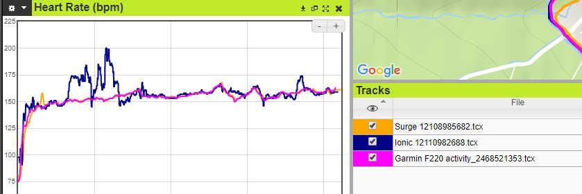

I've had my Ionic for a month, but it has been reporting some worryingly high heart rate values when running, over 200 on several occasions.
On Tuesday I went running with two other monitors. My old Surge, and a Garmin Forerunner 220 with chest strap.
This is a comparison of the results:
As you can see the Garmin and the Surge were in very good agreement. So much so that the traces are almost indistinguishable, if I turn off the pink I can see the orange underneath. The Ionic is very erratic, diverging from the other two by up to 50bpm on occasion.
I wear the Ionic in the recommended position, and tighten the strap one notch when running.
I don't think this is good, have I got a faulty unit?
I will try again today, with just the Surge in addition, the Garmin strap is horrible.

known issue since the first units starting shipping back about 4 months ago (Oct 2017).

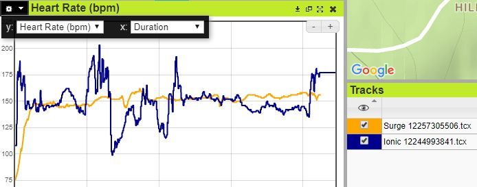

OK, it's broken. I thought it was a cadence lock, but it is all over the place when running. This does not look like it is normal at all. Has anyone had a replacement due to bad heart rate sensing, did it improve?
Best Answer02-07-2018 07:30
02-07-2018 07:30
Did you put them on the same wrist? If so, the high up one always get better HR in my experience.
Best Answer02-07-2018 07:48
02-07-2018 07:48
No, the Ionic was on one wrist in the optimum position, and the Surge on the other. The Garmin, when I wore it, was higher up, but that uses a chest strap. I was careful that the Ionic was not compromised.
I started doing this because the Ionic was giving me over 200 when it was the only monitor I was wearing.
I have never had over 184 and that was a half marathon on a hot day and I nearly collapsed at the end.
Best Answer02-07-2018 11:48
02-07-2018 11:48
Try flipping the ionic around so the face is against the inside of your arm. If you still get sporadic readings it's probably faulty. If you get a good reading it's probably the position you normally wear it in causing problems.
I flip mine around for sleeping, otherwise I don't get good enough heart rate data for the "detailed" view.
