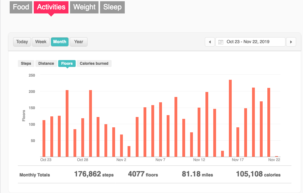

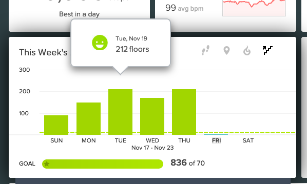

Morning guys my ionic is playing up
I’ve tried resetting etc but it started after using it in a swimming pool while I was on holiday
Basically it seems to think every step is up stairs
I used to do 30-60 flights of stairs a day but since I used it in the pool it shows as I’m doing 300 plus flights every day and I’m definitely not doing that amount every day! What can I do to make it right?
All other data seems correct

@jonathanjeter Thanks for getting back. I appreciate the screenshots you've attached.
In this case, I've shared your post with our Support team and they will continue assisting you.
