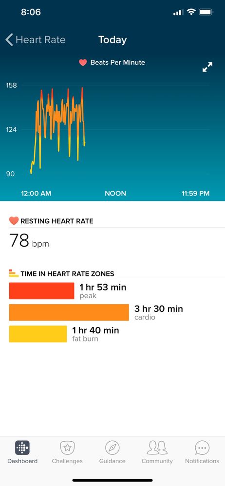

I've been dealing with heart rate inaccuracy for a while.  Decided to leave it on the night table last night next to my phone.  And this happened.  Any thoughts?
Clearly it had a very intense dream!
lol
OK, so what was going on on the night stand?? Smiley LOL
All joking aside, I'm really disappointed with this whole Ionic heart rate issue and Fitbit completely ignoring the issue as if it doesn't exist.

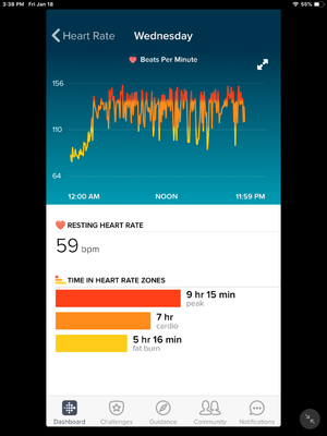

Yep the device simply is wacky!  This is what mine read sitting on my night table on Wed.  But since reading about the recall and EMF concerns have now turned off the device most times of the day.  Only turning it on to track Exercises.  So inaccurate is a gross understatement here.  But oddly the device gives ok looking data in Exercise mode with and without GPS.  In that way use the device now to track data like sleep and HR etc for set time periods for comparisons purposes only.  Limiting exposure to on body contact.
