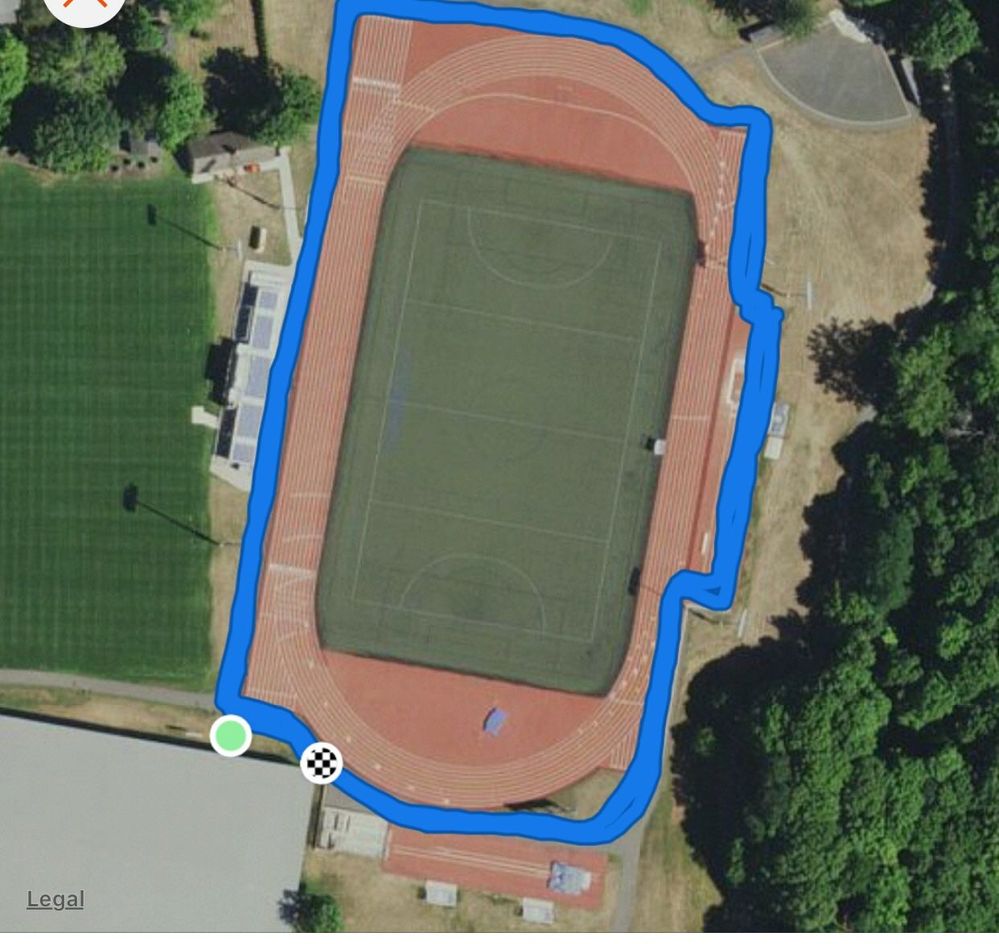

My observation here has been that the Ionic seems to have less of an ability to deal with trees blocking they sky above my run.
On my known 1 mile wooded path, the Ionic has measured anywhere from 0.93-0.98 mile. So with the trees I can’t seem to get even a consistently under measured distance.
Compare this to my run on a 1/3 mile measured loop in a wide open field around an NCAA track. I completed 9 loops and it measured 2.98 mile, which is basically perfect/within my ability to run the loop perfectly.
Yes, the actual path cuts harshly around the jumping lanes on the right side of the track.

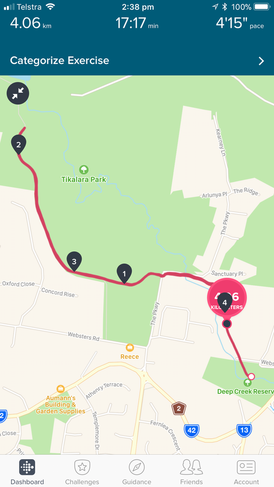

@DTFC1907Thanks for confirming what I was about to post. Mine was on a few Interval Timer GPS tracking and during the warm up section, but it was "connecting" for just on 2 minutes and only 140m before it Connected.. I was trying to get the connection to work and ambling. If I correlate your running to my ambling/walking it would appear a time issue because my timing would be close to your running distance
To confuse this.. After I ended that last Interval Timer I synced and examined the Intervals and saw the loss of tracking. So I decided to do a GPS Walk Exercise on the way back. The connection was immediate and the tracking perfect..
Comparing the distance and steps on both were well within 5% of each and made me realise that Fitbit's calculation included my steps x distance for the missing Interval Timer tracking...That was evident in the PC Activity Log...
In another topic I showed that the East/West tracking was accurate, just like the Surge and not like the Blaze issues we have in the Southern Hemisphere.. So I'm happy that Fitbit will provide a solution..
