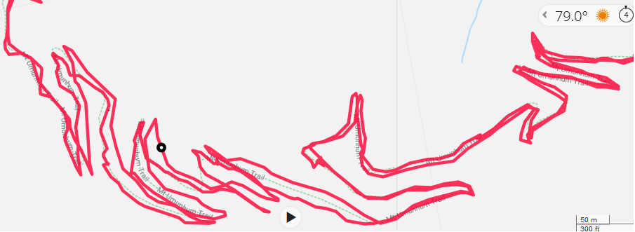

 In general I've been very impressed with the Ionic while mountain biking. I'm using the latest firmware update 32.10.20.
Although I was in heavy woods riding on the side of steep hills, I found the Ionic was spectacularly accurate!  While returning back down on the same switchbacks, the two Ionic GPS tracks are < 10' off. By comparison, the two Garmin GPS units (Edge 1000 and eTrex Touch 30) on my handlebars had tracks that were off by up to 100'. The Garmin GPS units were so bad the switchback trails were overlapping from upper to lower trails
Fitbit Ionic track on the side of a wooded mountain, showing accuracy with return tracks.

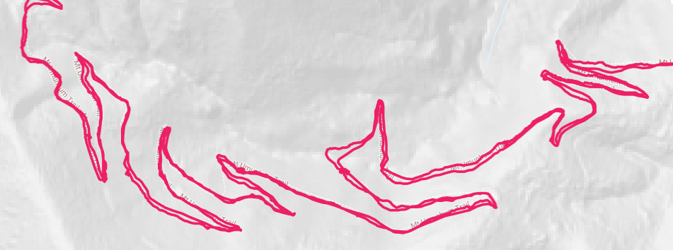

Garmin eTrex on the same trail as above.
The one issue I have is the total mileage for the Ionic seems to be ~3% low, odd considering the higher accuracy exhibited above.
