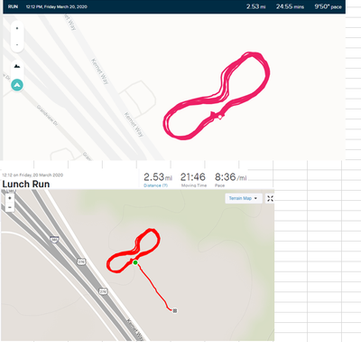

I call BS on the GPS signal explanation. Yes, the GPS can lose its signal, which will result in some weird traces, but as far as any differences between Strava and Fitibt goes for the same run, they are both using the same raw data from the Ionic, so that cant account for the discrepancies we see.
Did you use the pause button at all? Ive seen that using pause at points in the run will really mess up how Fitbit and Strava apps process the same raw GPS data from the Ionic. That probably goes for stopping to cross a road or whatever too when it might autopause depending on your settings.
Take the attached example. Both March 20 12.12pm, but Fitbit did not take "paused" time into consideration with the pace and shows as 3 minutes longer. However, the map stopped tracking after the final lap. Strava on the other hand, despite using the exact same data obtained by linking with my Fitbit account, gets the pace correct (So it does not include the paused time between repetitions), but for some reason it does shows the walk back inside before I hit "end" on the exercise session while the watch was only paused. Not even sure this is a "moving time" vs "total elapsed time" thing, its just weird.
Go figure. Bottom line is I trust the stats from the Strava processing more than the Fitbit analysis. And not just because Strava says I'm faster:)
Bare in mind here the Ionic is the only thing recording the GPS data, so all the differences are entirely in how the apps use that same data.

Thats is what i thought as like you said they both used the same Gps data. As it happens i did pause that activity at the halfway point while i caught my breath ! Maybe that is the cause although i have had variations with walks i have done aswell where i havent paused the activity. I think in the future ill just go off the figures strava give me ! Thanks for the reply btw
