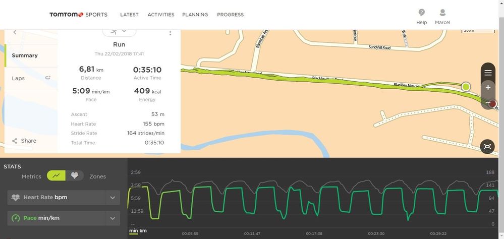

This shows exactly how bad Ionic's heart rate monitor is.
I took it for a Interval Workout along with a TT Running Cardio watch a couple of weeks ago just to see how Ionic performs in comparison to a proper running watch.
Firstly the avg pace Ionic- 5:37/KM, TT-5.09/KM. That is quite a big difference.
Distance Ionic-6.37km, TT-6.81km. Again, massive difference.
Elevation gain is a mess on ionic.
But the biggest mess is the Heart Rate. It's just horrible. Look at the graphs from both devices.
First the Ionic where my heart rate seems to be all over the place. Second the TT where you can see my heart rate (grey line) pretty much matches each interval.
So this only shows how bad and inaccurate Ionic's heart rate monitor is. This result's in false burnt calories count too.
