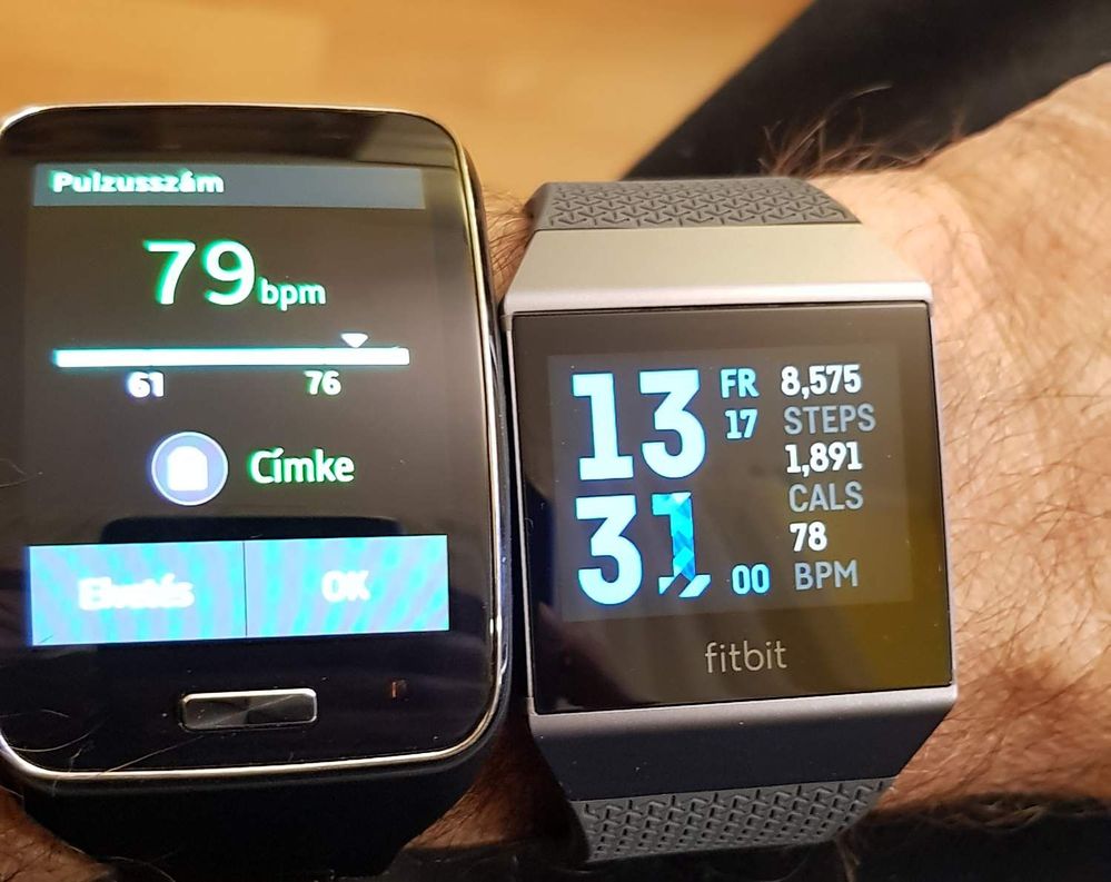

I do not know, but I use the Galaxy Wear S for a tenth of the same values.During sports and in rest. Fenix 3 and Vivoactive Hr also measured similar values. Like the Ionic.

try to get past 130 bpm and see if the measurements are still in the same ballpark among the devices you use... In my case (with my skin color, my watch positioning 4 fingers from the wrist bone) the Ionic displayed 140-145bpm and the Fenix 3 HR was in the 167-170 zone... and my heart was definitely in the 170bpm zone. I've waited a few minutes (took the lag into consideration) and the Ionic never got to 170bpm... I hope it gets better with time...
