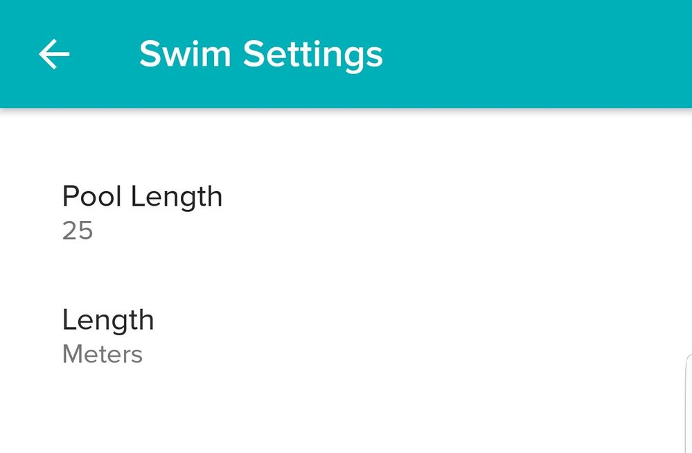

Have you tried changing the swim settings? If you go to your advance setting you can change your swim settings by setting your pool length. I believe it is automatically set to 25 and the length is in meters so you can change it to yards.
 If this isn't it, sorry I don't know to much about swimming.
You are partially correct.
Yes, you can change the pool length in advanced setting.
BUT, it will not store the change or allow it to implement.
This is a known problem that I have discussed with Customer Service for a week....
No current fix available...
Maybe on the next update this will be patched....

I also cannot get it to change to 25 yds instead of 25 m like another poster.
Can you update this thread if you get a fix?  I continually try to change it and it never "saves".

The ionic allows you to set the pool length in the settings of the swim exercise. I set it correctly to 25yd. Thanks
Did it save?   I have done it quite a few times and when I go back in it always is back to 25m.
yes the ionic setup screen for the swim exercise reports the pool length set at 25yd

I was able to set the pool length on the fitbit website (haven't tried on iphone app). But I also find easy to set on ionic directly, in the swim exercise settings.
I just set it to 50yd on my watch, left the screen, came back, still set at 50 yd. No issues there.
