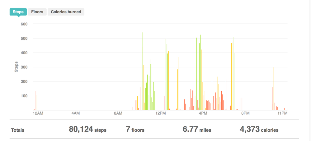

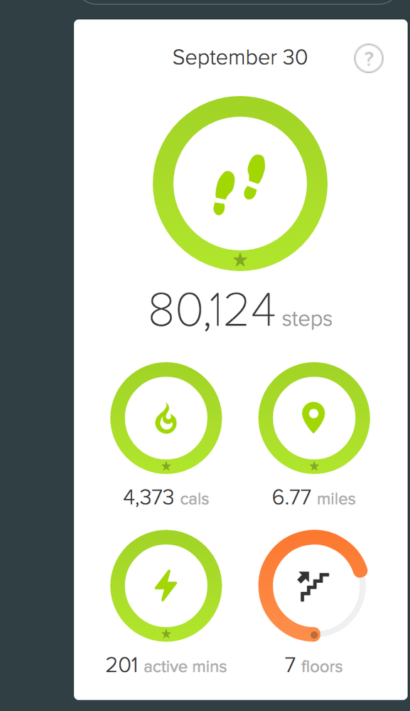

So I got my fitbit ionic yesterday and today when I woke up it showed 70k extra steps. Without reason. Cant understand why. Tried restarting the watch but it shouldnt be so bad. I mean its a **ahem**ing $300 watch.

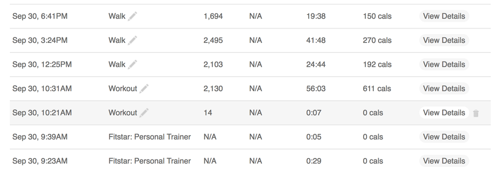

Thanks for responding.Apparently the steps dont show up on my activities so I cannot delete them. But they show up in a total. Looks like a BUG in Fitbit Ionic honestly. Maybe a calculation mistake or some kind of randomness. I have attached the pictures from my activity logs.Activity Dashboard.pngActivity logs.pngStepLogs.png

Thanks for the extra details that you've shared @PDeshpan! The steps that you're getting don't need to show up in activities for you to delete them. You can just log driving for the morning or part of the day and the extra steps will be deleted. I would like you to double check that you've restarted your tracker by following these steps

That does not work. I logged driving for the whole day. It did not change anything. I tried restarting my FITBIT IONIC many times. No use
I tried logging "driving" for the whole day. Did not work. I tried restarting the FITBIT IONIC multiple times. No use.
