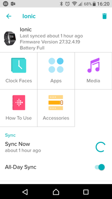

btw regarding Wifi it is tough to setup it - I can not do here anything because I can not get strong connection for watch. I just se eternal spinning loading icon.
But I must add it connects somehow once a day to fitbit cloud, because I see it was updated 1h ago, I have no idea how and where, when I try to do it manually it jyst shows me spinning circle and I do not remember when was the last time I saw notification about call or anything.

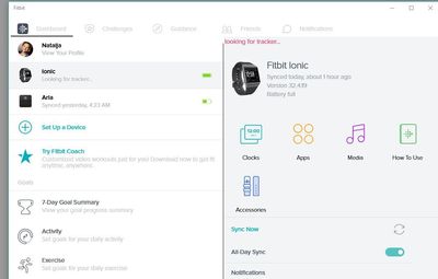

From my latest experiments I tried to connect it via wire and the bluetooth (fitbit bluetooth usb device). If I unplug this fitbit usb module, it shows pink triangle and says bluetooth is off, as soon as I plug it in, triangle disappears. Looks like it pairs, but does not sync. Can not access wifi setup from windows app either. It says bluetooth is off (no idea why, fitbit module is plugged in).

This is my message when I try to setup wifi here.
Regarding windows 10 app I see this:
after few seconds message "looking for tracker" disappears, nothing else happens both ionic connected via wire and Fitbit station plugged in.
