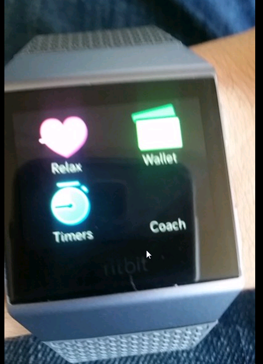

 After being so happy with them, notifications don't seem to be working anymore which is a symptom of sync issues, also after removing and re-adding my fitbit phone app crashed multiple times and once told me there was a sync issue. bleh.
Update 9/29/17 -- Our engineering team has confirmed that the syncing issue has been resolved. Yay! Thank you all for bearing with us as our team worked to get this sorted out. Man Happy
@ggalexgg Are you unable to receive any notifications? As for the Coach app, have you tried removing the app and adding it back to Ionic?
