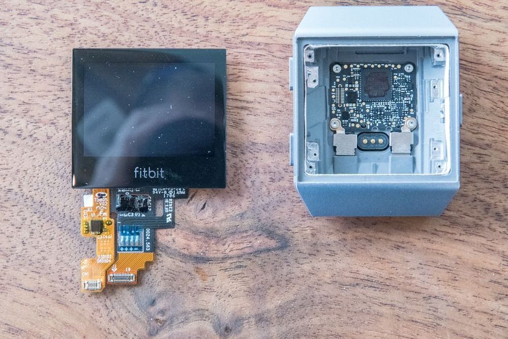

I’d be interested to see the underside of the display because it may be a sealed unit in its own right and the light bleed isn’t a big issue if, and it’s a big if, the seals are working. I don’t know how badly aligned the ones that got water ingress were. In some ways I’m tempted to hold on until it breaks, or something more definitive arises.
I'm guessing it is a sealed unit, this is the only picture I can find of the display out of the device. Haven't found any of the back of it.

@N8teGee It makes me think that possibly the light bleed is from the edge of the glass, not from underneath, which is sealed. Perhaps the “blacking” is not perfect. Clutching at straws possibly.
@SunsetRunner I think that could quite possibly be the case.

Yes, at moment I have no idea if my device may fail if I take it for a swim. Seeing how the screen is secured and sealed could reassure myself and others.
