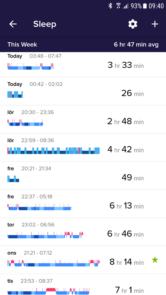

Best Answer04-08-2018 00:48
04-08-2018 00:48
Friday it probably logged good.
Deep sleep i assume it logga good.
Still awake time laying still in bed shows as a combination of awake, rem and light.
Putting example picture:

@Peter76 Thanks for your reply and for sharing this information and screen shots.
I'm glad to hear it shown correct for Friday. Would you say it is now working properly or do you still feel it is being inaccurate?
If it is still being inaccurate I can help you out by creating a case with customer support in your behalf. That way they can take a deeper look at this.
Keep me posted!

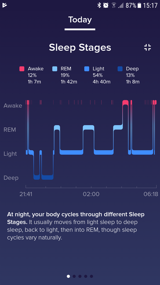

Best Answer04-10-2018 06:24
04-10-2018 06:24
Great! I assume it is best if you open a ticket.
I attach image from last night. I was awake before 04:00. I got up at 04:00 and ate breakfast untill approximately 04:25. Then back to bed and tested until ~06:10.
So there is some hours awake registered as light sleep, rem and awake.

@Peter76 Thanks for your reply and for sharing another screen shot with valuable information regarding your sleep logs.
I went ahead and created a case with customer support for you to get further assistance. Please keep an eye on your email inbox for next steps.
