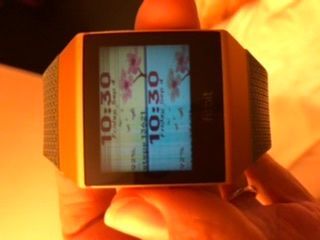

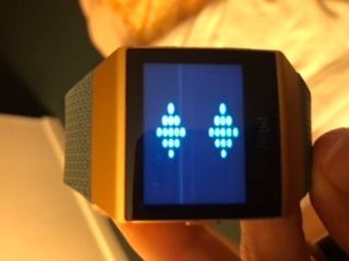

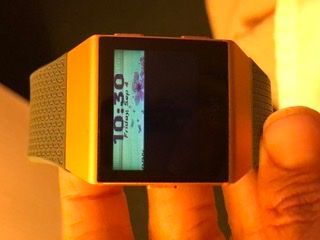

I’ve done a lot of reading on this and have followed the suggestions. I’ve restarted my FitBit Ionic several times and the glitch is still happening. I’m saddened that this glitch seems to be so common. For what we paid for the Fitbit I’d love to see more reliable quality. My device is just under three months old. It started about a week or two ago with the Fitbit logo randomly popping up, then today after a 20 mile bike ride I noticed the screen glitching out.
I need to know who to contact regarding this issue.

@PhaeWilk Thank you for getting back. I truly appreciate the pictures attached showing your Ionic screen glitching.
Sorry to hear that you're experiencing this with your watch that's 3 months old. In this case, I've shared your post with our Support team and someone will contact you as soon as possible. Keep in mind that due to recent events affecting our operations we may take a bit longer to get back to you.

Thank you Silvia. Someone did reach out yesterday. I picked a new fitbit approved watch face and installed the new system update. The glitch is not gone and became worse throughout the day.
Today was my first time trying to wear the fitbit since the glitch appeared on Friday. It was nice to be able to track data again, but the screen issue is frustrating. I used it to track a walk this evening and by the end of the walk their was barely a display - I had to guess where the end button was because I couldn not see it. I've sent the support email updates throughout the day with pictures and videos. I will be trying a factory reset next.

Did a factory reset. Issue not resolved....and I forgot to sync before doing so and lost the workout/steps I just did. 😞 I was able to manually log. Sent update and pics to the support network. I get the delay, but I have an expensive devise that was a gift that not even three months old that doesn't work.

@PhaeWilk Thank you for updating the thread with the pictures of your Ionic's screen.
Sorry to hear that even after performing a factory reset the display hasn't worked and you lost your workout steps. Please continue the communication through email, our team will be more than happy to continue helping you.
