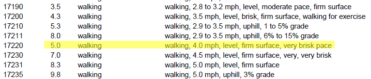

Here are the METs for various walking activities (taken from the 2011 Compendium of Physical Activities😞
The closest to your speed is 5.0 METs. This means energy expenditure performing that activity is five times your BMR.
Now I’ll use this online calculator to estimate your BMR. I’ll assume you’re 40-yo and 6’ tall (does the consensus on the internet know your age and height?). With these assumptions, your calculated BMR would be 1768 calories. That’s 1768 / 1440 = 1.225 calories per minute (there are 24 x 60 = 1440 minutes in a day).
For the duration of your activity (80 minutes), energy expenditure would be 80 x 1.225 x 5.0 = 490 calories.
Now, are you saying that if you record a 80 minute walk at 3.75 mph on your Charge 2, it claims you burn 500 x 5 = 2500 calories during that activity?! That would be insane indeed.
