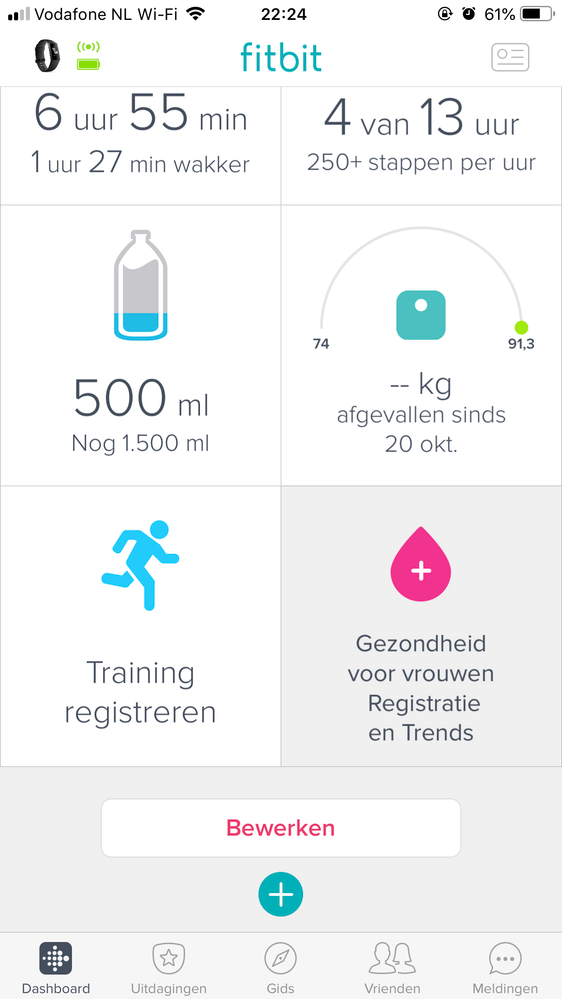

Hi! The Fitbit app is up to date. But i still have to update my iPhone to iOS 12.0.1. So I will update this now first to see if this will fix the problem.
So I updated my iPhone and it is still not working.
The tile is still “grey” when i tap on it. See screenshot.

Hi a-k-b,
I have the same issue, did you find a solution yet?

Hi @YojanaFitbit,
I have a iPhone 8 plus.
I still have the same grey tile as in the screenshot I send earlier.

Hey,
I have the same problem, the tile is grey, my phone is an iPhone 6s.
Screenshot is the same as previous.
