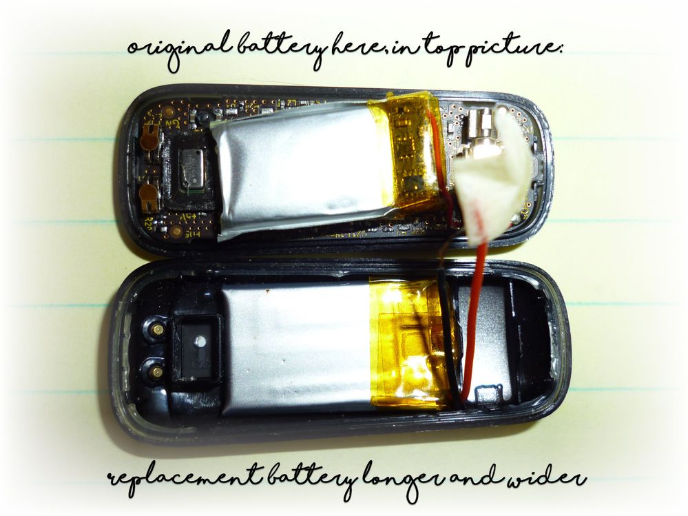

I've just tried my own Fitbit One fix - my old One's battery life died to the point it was unusable, so I bought a replacement battery on eBay for less than £12 and fitted it myself (two wires to solder). I was quite surprised when the display lit up, but now it's got a new lease of life.
Only difficulties were opening it up - it uses tacky elastic-like glue which needed warming up for easier prying, and re-gluing the case back together afterwards - it's fiddly removing the stringy old glue. It's probably less water-resistant than it was, but meh...

@Sparkytwo @dlorde this is what I did as well, very easy install (my first solder job). The replacement battery is slightly larger than the original. I used a heat gun to briefly warm the outside of the tracker and it opened easily with a pocket knife. Photo attached in case this helps anyone. Cheers!Fitbit Battery Replacement.JPG
@Williger - that's interesting; the replacement battery I got was identical in size to the old one, but the little circuit board at one end wasn't quite as flush-fitting. It didn't seem to matter as the case had enough room for it.
