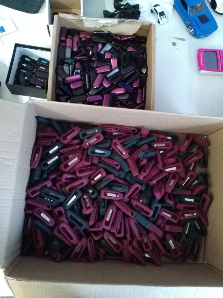

@Rich_Laue it's rare but happens. Out of the 300+ Ones pictured below, most are dead or have limited battery life, the ones in the top left box all last well over a week. Regarding firmware updates, @menorevs is 100% correct, (1) 6.46 won't update and it's frustrating as there's no way to downgrade to a version that's upgradeable, and (2) they seem to work fine but annoyingly don't update, missing battery life benefits. PS. @menorevs you've not been active in a while but if you're still around, shoot me a PM, I have referrals you may be interested in 🙂
330 Fitbit Ones. 22 Work Great.
