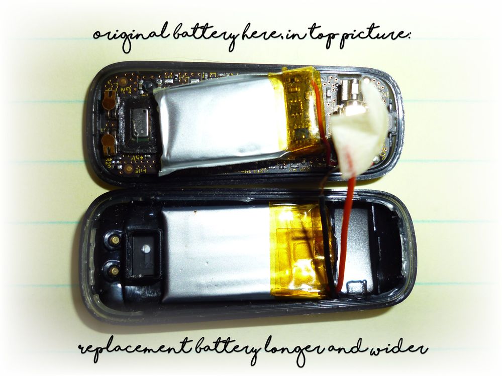

Hi, @Snowcrasher
I replied to your battery questions in this thread and here too, (this thread, previous page) which I'm unsure you've seen. All I've found in the forums are my pictures and those from one other user, who'd shared theirs as well. Strangely, one thread where I'd detailed the differences between my technique and the other user does appear to be missing. Maybe Fitbit deleted it, as they don't want us self-repairing? I'd assume they'd send a note if sharing that information was prohibited. Click the links above, and hopefully, they'll help. FWIW, my One is showing half-battery and into its 3rd week since charging. FYI: The [large] replacement battery I purchased is working for me better than the original, even when it was brand new. I used to get 10-14 days out of a charge. Cheers! 😄
NOTE: There are different sized replacements, check before ordering!

I had the page open to that other post that disappeared and a few days later when I refreshed it said that content was no longer available so Fitbit must have deleted it. I will use your other post as well as youtube videos on battery replacement to attempt my own repair. I was tempted to wash it out with fresh water and re-dry it again in rice, but I'm pretty sure the battery is now bad so that seems unproductive. Until the incident, the battery was fine (It was purchased 3.5 years ago).

Don't flush your One with water, you'd risk further potential damage. Once opened, if you see corrosion on the PCB you can investigate cleaners, but as you mentioned, the battery is most likely either dead or loose from the circuit board.

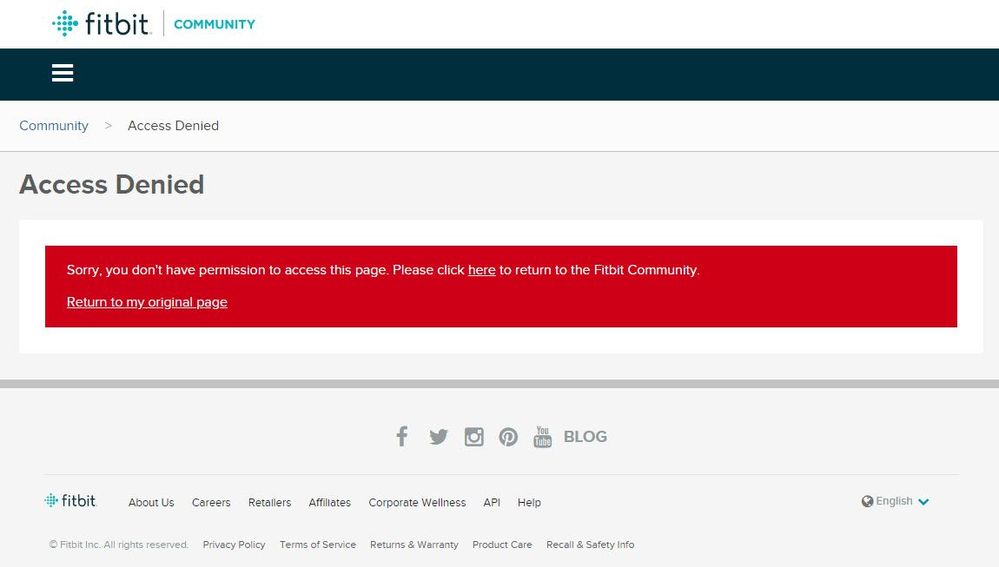

The thread "Fitbit One won't turn on but is fully charged" was completely deleted.
I'm baffled but I'll go away so no more threads about the One with helpful information disappear.

@hmjo @Chrissy1 Your battery is probably dead. 6.__ firmware proceeded my battery dying too, only showing a false full-battery indication and the firmware revision momentarily while in the charger. It's amazing many of these trackers have lasted 5+ years!!
The One was one of Fitbit's first (and still one of the greatest) trackers! I'm psyched many still operate. For those with the dead battery, fortunately, there are aftermarket replacements available. Installation is as simple as attaching a couple of wires. If DIY isn't up your alley, you can probably find a friend familiar with using a soldering iron for the quick install?
Firmware 6.64 includes modifications to battery life. Unsure why it appears to make old batteries die, it makes new ones last for over 2 weeks.
