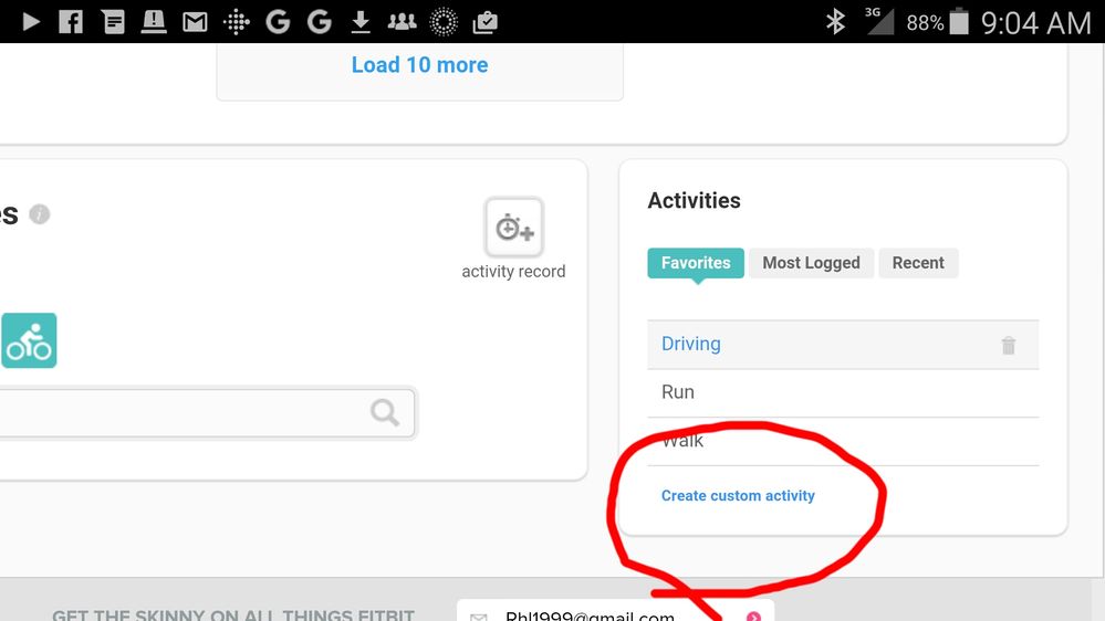

I'm having a very similar problem with manually entered exercise on my iPhone not syncing. Except for me it seems to depend on the type of exercise entered - if I log a spinning session it syncs with no issues whatsoever, whereas body attack gives me a pink/red "(not synced)" message and doesn't count on the number of days exercised this week icon or appear on the web version. There's no issue in syncing with the steps, floors or any other features, just certain types of exercise.

If you noticed when adding spinning This activity showed up in a drip down list that can be tapped on, while Body Attack did not show up. This will require you to create a custum activity for Body Attack, and will need to be done through the web at https://www.fitbit.com/activities

As an Android user I've never had the ability to enter a custom activity from the App. I could move this post to the iOS forum, it would be helpful if @SunsetRunner could edit the title to "Trouble entering a custom exercise".
