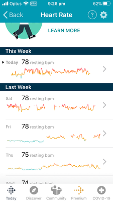

This gets a bit messy - my small size wrist band broke - not sure now if before or after the update - so I went to the larger size and adjusted accordingly.
after I did the update on Friday 14th to 1.88.11 the Charge 3 went ballistic as some described - vibrating on/off and screen flashing - this went on for several hours - finally settled. Note up to this point Sleep Tracking had been fine - that night it crashed out at 3.21am and only logged 2h52min sleep since then I have received no sleep scores as the device is having trouble detecting a reliable heart rate. The heart rate detector is not registering correctly at all - it is out by 20/30/40 beats per minute. It is erratic. My resting heart rate due to this has gone from 73 to 78. Note I check pulse by manual count and when doing Blood Pressure checks. I also not Calorie count at point of waking is already around 400 calories plus when waking in past at comparable times. Note also I no longer receive the “fireworks” when I achieve 10,000 steps. I have rebooted device several times. This unit was a Xmas gift and after eight months a problem. The fact that the wrist band separated - just fell apart is also a worry as I rarely removed the device. If I could reload the software would it help? How would I do this? Exasperated in Oz. Can anyone help - is Fitbit out there listening?

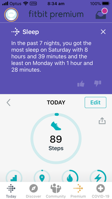

The story continues woke to this Premium notification the Monday figure is actually 8hr12 min the lowest was Friday 2hr 52min but only because the heart rate monitor gave up the ghost. I won’t be taken up the Premium
at the end of 3 month trial. I certainly did not achieve a 4859 calorie burn yesterday. At the heart of the matter is the HEART RATE SENSOR - and don’t tell me it is the WRIST BAND or a reboot or a factory reset or DELETE Charge 3 and add It back in. I figure it is a serious SOFTWARE ISSUE as I read this forum I have experienced ALL OF THE ABOVE. When will our FATBOTs be fixed??????????
