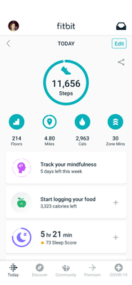

My floors are wildly off! I've only had it for about 3 weeks and it was fine the first week. Now I literally roll out of bed and it says I have climbed one floor. My bed's not that high! I work at home in my basement right now I walked down two floors and put it in an 8 hour day and at the end of the day it's that I had climbed 60 floors! I'll try restarting but this is one of a few things that have been off. I also have the charge 3.
02-02-2021 21:04
02-02-2021 21:04
Today I "earned" my Castle Badge: apparently I climbed 200+ flights of stairs! Captured a screenshot for evidence. Dang, I've been busy doing a whole lot of nothing.
Garbage.

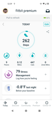

My Sense gives me several hundred floors per day when only a few floors is reality. Here is my Fitbit a half hour after waking up; I have barely walked 250 steps in the bedroom and kitchen and it thinks I've already climbed 9 floors... Hopefully there is a fix?
And hopefully the erroneous floor count isn't inflating calories burned.
