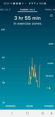

Odd behavior? How about this for odd behavior...
All the above happened in the past 24 hours.
I put it on the charger at 17:35 wit a 78% charge. At 20:40 my charge 3 had a smiling. Battery (100%). It's now back on the charger indicating ~35%, 4 hours later.
Odd enough for you?
Edit: I took it off the charger fully charged, and after a couple minutes, I felt a few soft vibrations on my wrist. I looked at the Charge 3, it smiled at me, then went unresponsive. App even says device not found.
