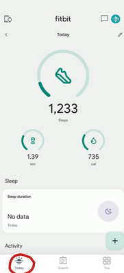

Thanks for getting back to us and for following advised troubleshooting steps @Jgordey. I'll keep helping you.
Today's tab is on the Fitbit app:
