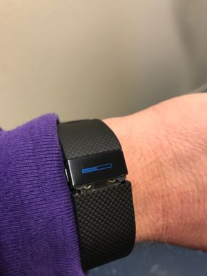

Hi Ferdinand
Nothing seemed to work and now this flatline symbol has come up.  How can I send you the photo?
Regards
Theresa
Can anybody help still no progress on my Fitbit all I’ve got is a line across the middle of the display half lit up and half black

Hi @Theresab4961 ! Thanks for coming back and for doing everything suggested on @FerdinandFitbit's post. I'm sorry for the delay on this response. I appreciate also the image that you attached. Please note that the bar that you are seeing on the display is the firmware update progress bar, this is the reason why you have syncing issues and battery draining. I will advice to follow this steps to update the Charge HR, if this doesn't help unpair your Fitbit, and set it up again, the update will be done automatically. As for the band issue, I have created a case for you on our support department, they will be in contact shortly, please keep an eye on your inbox.
