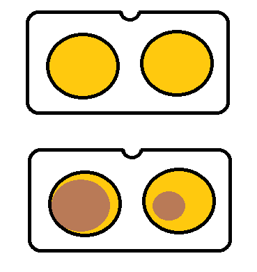

It is hard to see in the picture, but where the copper connection terminals are... they aren't there. It looks like plastic. You can still see a bit of the copper connection material on the outside edges but nothing in the middle where the charger physically/electrically touches/connects to the CHR. Over the years the CHR has progressively gotten worse that you had to fiddle with the connection more and more to get it to start. Once you found the sweet spot it would charge. My guess is that this was because you'd be wiggling it until it moved to a spot with the terminal still intact... and now the terminal has receded too far so you can't wiggle it into submission.
I'm just wondering if anyone has had this problem.
I feel like my only fix would b to get a soldering iron and dab a touch or solder on there and "remake" the terminals.

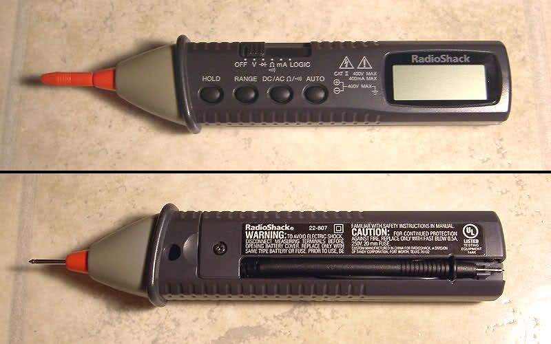

Was thinking, check the prongs with a multimeter. Not sure if you or a friend of yours has one.
I have an old radio shack meter that I would believe "beep"when I touched those 2 prongs.
Also in volts DC, you should see a reading on the meter screen.
Let me know if you want me to try it on my good working HR.

The problem isn't so much that it won't charge but rather that the terminals are eroded. Instead of two round connection terminals on the CHR mine has two ports but they aren't copper anymore... They are black/brown in the center (where the cord terminals would touch) like there is no more conductive metal there. It looks like fitbit makes those terminals by simply coating the plastic chassis with a conductive material. If you look real close in my picture you can see that the terminals look eroded in the middle (sorry for the shoddy picture of the issue as I don't have great macro camera gear at the moment).

Below is a drawing of what the terminals used to look like and below is what mine looks like. If you look closely at the original picture in the original post you might be able to make it out better with the below graphic.
