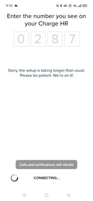

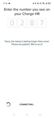

Hello, my fitbit charge HR hasn't been used in a while, I've gone and fully charged it so it has full power but it won't sync.
I have an Android phone.
*I've tried uninstalling and reinstalling app.
*I've turned bluetooth on and off
*I've turned phone on and off
It gets to the part where I enter the code and just won't leave to page no matter how long I wait for it to connect.
Sometimes I'll also get a message saying its unable to connect.
To make sure no other devices nearby - there isn't
Make sure it's charged - it is, it has full power .
It syncs to my son's fitbit totally fine so not sure why it's not syncing to this.
Hoping someone can help..thanks

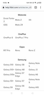

Which phone do you have and is it on the list of compatible devices? click to see

Hello, thank you for your reply. I have an Oppo reno z, so yes it is compatible I also have the latest software.
Ive deleted and reinstalled app again and still not working.
The other fitbit that works and syncs with no issue is not nearby, but I also disconnected it from my account and still not working.
Nothing else is paired to my bluetooth and location services are on and fit bit has permission to run in the background.
No other device is used to sync so that is not the issue either.
My phone is the only thing I have to sync the fitbit

Sorry, I'm confused. You're saying my device isn't compatible?
I have an oppo reno z.
Why it is it on the list of compatible devices if it isn't ??
Best Answer09-13-2020 05:12
09-13-2020 05:12
It also say Android OS 7.0 or higher. And mine is running on 10??

Both phones say they've found my device but it just won't connect
Could the issue be with the fitbit itself?

Just tried. Still not working unfortunately.. just stays on this page
